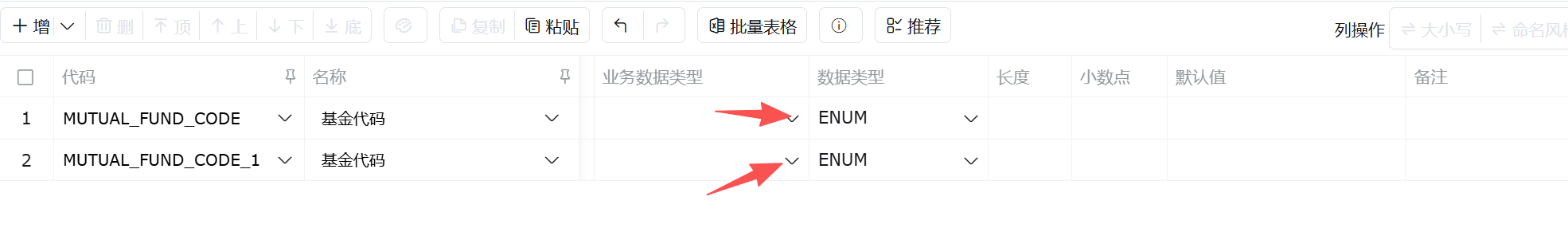

  1. 先将字段设置成枚举类型,如下图

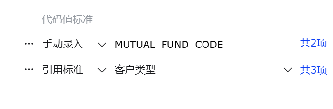

  2. 给字段设置代码值标准,用来作为枚举值来源(注意:代码值标准有两种来源方式),如下图

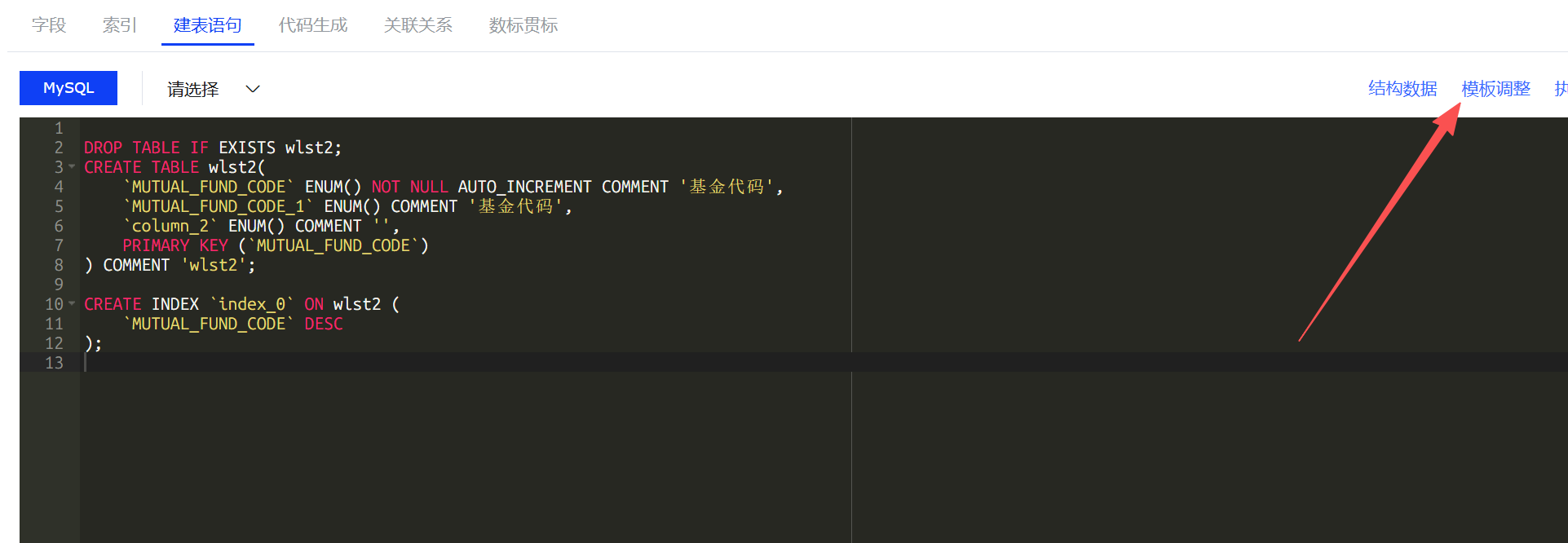

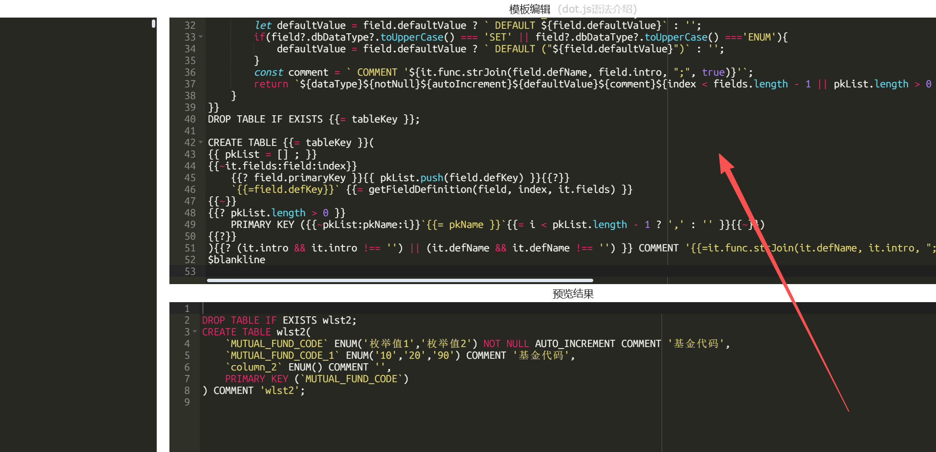

  3. 修改代码模板,如下图
    模板如下(复制进去即可):
    let schemaName = it.schemaName ? `${it.schemaName}.` : '';
    const tableKey = `${schemaName}${it.defKey}`;
    function getDataType(field) {
        const { dbDataType } = field;
        if(!dbDataType) {
            return '';
        const dataType = dbDataType.toUpperCase();
        if (['VARCHAR','NVARCHAR','VARBINARY'].includes(dataType)) {
            return `${dataType}(${field.dataLen ? field.dataLen : 128})`;
        } else if (['DATE','YEAR','TINYTEXT','MEDIUMTEXT','LONGTEXT','TINYBLOB','MEDIUMBLOB','LONGBLOB','BOOLEAN','FLOAT','JSON'].includes(dataType)) {
            return dataType;
        } else if(['SET','ENUM'].includes(dataType)){
            return `${dataType}(${(field.dictItems || field.stndDictData?.dictItems || []).map(d => `'${d.itemKey}'`).join(',')})`;
        } else if (dataType === 'TIMESTAMP') {
            return field.dataLen && field.dataLen >= 0 && field.dataLen <= 6 ? `${dataType}(${field.dataLen})` : dataType;
        } else if (dataType === 'DOUBLE') {
           return field.dataLen && field.dataLen >= 0 && field.dataLen <= 255 ? (field.numScale && field.numScale >= 0 && field.numScale <= field.dataLen ? `${dataType}(${field.dataLen},${field.numScale})`  : `${dataType}(${field.dataLen},0)`) : `${dataType}`;
        } else if (dataType === 'DECIMAL') {
            return field.dataLen && field.dataLen >= 0 && field.dataLen <= 65 ? (field.numScale && field.numScale >= 0 && field.numScale <= field.dataLen ? `${dataType}(${field.dataLen},${field.numScale})`  : `${dataType}(${field.dataLen})`) : `${dataType}`;
        } else {
            return field.dataLen && field.dataLen >= 0 ? `${dataType}(${field.dataLen})` : `${dataType}`;
    function getFieldDefinition(field, index, fields) {
        const dataType = getDataType(field);
        const notNull = field.notNull ? ' NOT NULL' : '';
        const autoIncrement = field.autoIncrement ? ' AUTO_INCREMENT' : '';
        let defaultValue = field.defaultValue ? ` DEFAULT ${field.defaultValue}` : '';
        if(field?.dbDataType?.toUpperCase() === 'SET' || field?.dbDataType?.toUpperCase() ==='ENUM'){
            defaultValue = field.defaultValue ? ` DEFAULT ("${field.defaultValue}")` : '';
        const comment = ` COMMENT '${it.func.strJoin(field.defName, field.intro, ";", true)}'`;
        return `${dataType}${notNull}${autoIncrement}${defaultValue}${comment}${index < fields.length - 1 || pkList.length > 0 ? ',' : ''}`;
